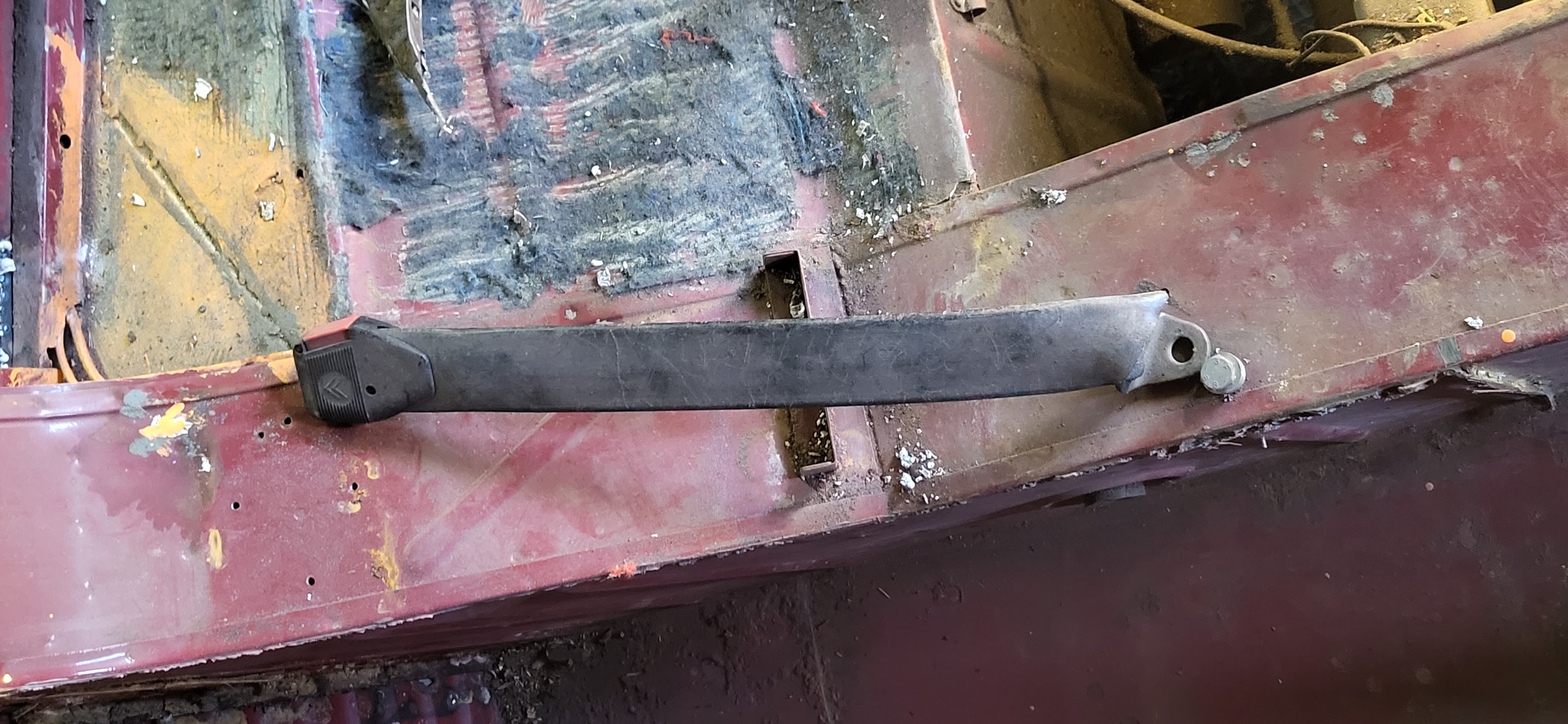

Hi Kat and Garric,
As promissed I made some pictures from the mounting places of the belts.
I hope this gives you the wanted information. Of course you have to make your own reinforcements to make the needed firmness.
If you need more info please let me know.
Kind regards,
Dries
The right seat left lower mounting. This has a long plastic cover.
The right seat lower mounting
The right seat upper mounting

Many Thanks Dries!
Sorry for the late reply. We appreciate you taking the time to photograph!
Best,
Kat & Garric

I think this migth be pretty difficult, sice Citroen welded bolts on the inside of the b-style / b-frame and possibly also reinforcements (has anyone on this forum ever opened a b/style and taken pictures from the inside? , maybe from the outside for rentoration?) to make sure you fixate the properly and you don't tear them out if you ever use them you should recreate these bolts and reinforcements (and open your b style) or create a similar construction outside the b style to fixate the seatbelts upon.
